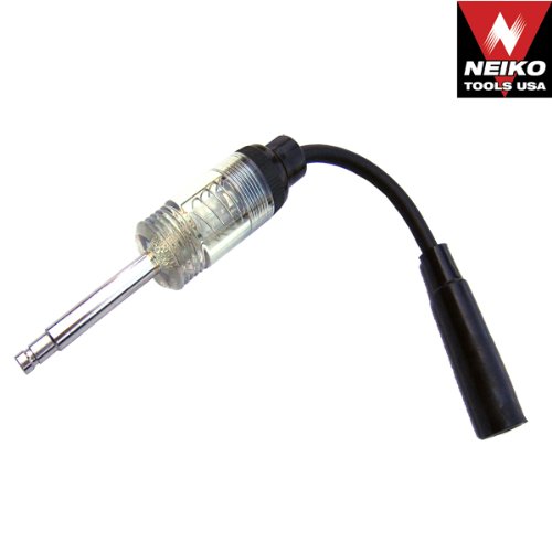

When you say spark plug gap tester, do you mean one of these? I have one of these things:
Thanks again. Will update tomorrow

Exactly like that but I am not sure that one is adjustable. Might do the trick anyway
Will be interesting if this is the problem
