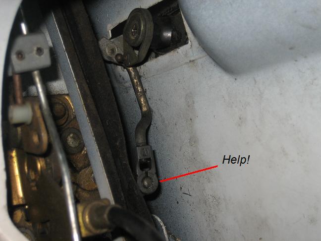

OK, maybe I'm having a blonde day, but I'll be stuffed if I can remove my exterior door handles. I've read the Haynes description til my eyes bleed, along with the helpful hints here - but I'm still stuck. I can't figure out how you can possibly remove the handle without detaching the activating rod (reverse lever?) via the plastic bit on the bottom of it. Or maybe you have to detach it from the top where it connects to the handle mechanism...?
I've even removed the interior panel to get a better look at it all - here's a photo with the rod in question highlighted. As you can see I've removed the "white plastic bit" that attaches to the back of the barrel. Why is it there's no mention anywhere of the rod...?
Thanks in advance,
Gavin.
PostPosted: Sun Aug 27, 2006 5:35 pm    Post subject: Reply with quote
Usual story... post a question to find an answer yourself... I simply wasnt pulling hard enough on the rod to remove it. Still cant see how you could possibly remove a handle without taking the interior panel off though...
Gavin.

Although it's a bit of a PITA, it's still easier to pop BOTH plastic connectors off, after releasing the door handle.
You remove the screw from the doorjam, then manipulate the door handle to remove it from it's position. then while holding the door handle alongside the door, you reach in with a pair of long nose pliers to disconnect both plastic connectors.
Reconnecting the plastic links to install the door handle, use the reverse of the above procedure.
You DO NOT NEED TO DISCONNECT the plastic links and completely detach the door handle from the car to replace the plastic seal/gasket pieces that fit between the door handle and the door. The larger piece can be slipped onto the smaller side, and slides all the way across to the larger side where it belongs, without disconnecting the linkages. The small side goes right on to it's spot.
