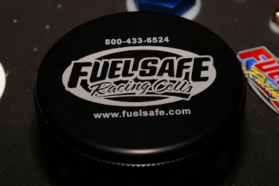

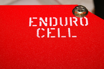

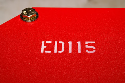

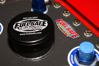

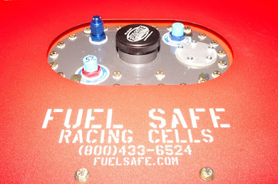

E85-prepped Fuel Safe Enduro ED115 (15 gallon) fuel cell (FIA certified and approved for SCCA and NASA venues). For details on the protective cage and installation, see my body work thread.

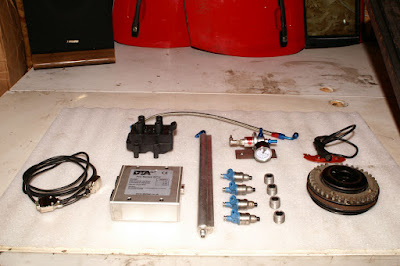

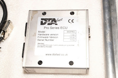

DTA Fast S60 Pro ECU and DIS, coil pack, custom aluminum fuel rail, FPR, injectors, crank trigger, etc.

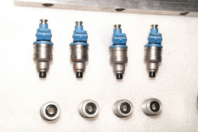

Fuel Injectors (these happen to be Mitsubishi Evo 460cc high impedance injectors, but I will be replacing these with higher capacity injectors, specs TBD).

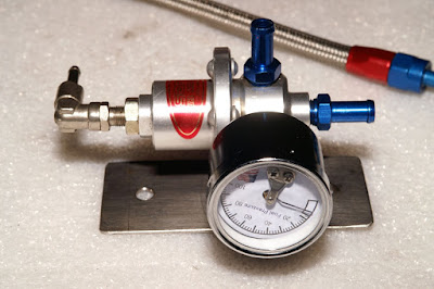

SARD adjustable FPR:

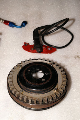

DIS crank trigger and sensor:

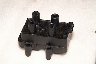

Coil pack:

PostPosted: Wed Nov 12, 2008 4:22 am    Post subject: Coil Pack Reply with quote
Not sure how the DTA system is setup but.I used one of those coils and had an intermittent misfire until we reduced the dwell time. We lost spark power and I went to M&W kit sourced from Steve Bassington and it is def better as a result.
Cheers
Simon
Blown is always best!

Misfire with higher dwell indicates two things: either you have crappy ignition leads or ECU doesn't support overlapping dwell feature and you are running out of dwell time at higher rpm's.

It`s pointless running any longer dwell than it takes to fully saturate the coil. Increase dwell slowly while measuring coil current and STOP when optimum max current is achieved. Any longer only overloads the drivers, the coil winding and insulation, and will cause ringing or secondary discharges, ie. misfire.
Modern ECUs such as this DTA will reduce dwell if RPM raises above cycle time. A calculation will show it`s not a problem on a 4 cyl. Especially as this system appears to have 2 or possibly 4 coil drivers. A good coil should function well at only 1mS dwell anyway.

PostPosted: Thu Nov 13, 2008 1:08 am    Post subject: Reply with quote
I think the other problem Simon had was due to the fact he was running wasted spark ignition. So the coil was firing the same plug twice every cycle. If the dwell time was too high, then this would start to overheat the coil, and cause misfires. he has since gone to an M&W CDI i gave him and run it in full sequential mode.

PostPosted: Thu Nov 13, 2008 1:26 am    Post subject: Reply with quote
Running wasted spark DOES NOT cause any misfire. It's not about the type of coil, but rather how ECU handles it.
I always tune to enough dwell not to give misfires and that's it. In most cases I don't run even factory recommended since it's not needed.
I've used both wasted spark and sequential on many engines up to 12 000 rpm and no problems whatsoever.
For example, recently I installed vems on Honda H22 and used exact 4cylinder coil-pack and that car revs up to 11 000 rpm, no misfires (vems has misfire detection also). Dwell is set to 3ms (coil is rated 4ms @ 13.5V).
And proper way dealing with rpm cycle vs dwell duration is overalpping dwell (next coil's dwell time is started before previous coil's dwell is stopped), not by reducing dwell time.

PostPosted: Thu Nov 13, 2008 10:20 am    Post subject: Not wanting to Dwell on this but........... Reply with quote
Lots of knowledge as ever, great strength of this list is the number of people who have done this and that and are willing to share the learning.
In my case I was runing wasted spark as Steve has mentioned and using a coil pack commonly available for small saloons with Emerald M3D management. The dwell was 4ms (I confess that as it had never caused a problem we hadn't really noted it) and although we had always seen the odd misfire it was only when we upped the boost a little did it become a serious issue.
We then noted the higher dwell and reduced it to 2ms and the misfire went away. However at that time I decided that the system was too borderline for where the car was/was going to be hence the move to MOTEC and M&W.
What I can say with confidence is that at both of those steps the running improved. So I whilst I think the M3D system was great, I am sold on the MOTEC plus M&W system .

Dan,
I would recommend the 60# siemens injectors.
But can I ask what you paid and where you got your fuel cell. All the local guys with that style of cell want around $1050USD for it.
3 928s,
PostPosted: Tue Nov 18, 2008 1:08 pm    Post subject: Reply with quote
Yep, that's what bass gt said too, so those are on my shopping list for sure, especially with the E85 plans.
I purchased mine from Racer Parts Wholesale. Mine has the steel outer box, which weighs about 4 lbs. more than the aluminum version, but costs $150 less. I spent less than $900, and that included shipping, special plating on the fill plate, and installation of the Fuel Safe Surge Tank Collector. All of the fittings are -8AN.

Thanks Dan, I think I may look them up and go from there.
Btw for the injectors, keep your eyes on ebay. I got 8 of them BRAND new for $200 + shipping :O most of the local places cost is $50/inj

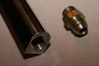

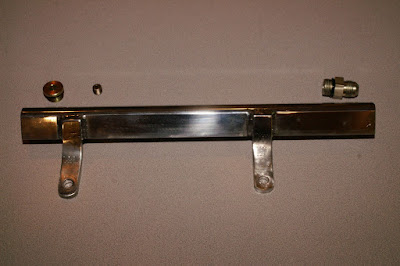

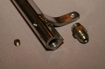

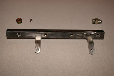

Custom fuel rail is nearly done, just needs anodizing:
Just a quick follow up on the injector issue. I had a conversation this week with my friend Scott Hoag (owner of Mustang Racing Technologies). He warned me against the Siemens injectors because MRT was experiencing as much as 20% variance across a set of 8 injectors. They lost two motors before they isolated the problem. He recommended that if I decide to stick with the Siemens injectors to make sure to find a supplier willing to provide flowed-and-matched sets.
In the meantime, Vaughan is working an angle to source comparably spec'd Bosch Motorsports injectors. Should know more in a few weeks.
