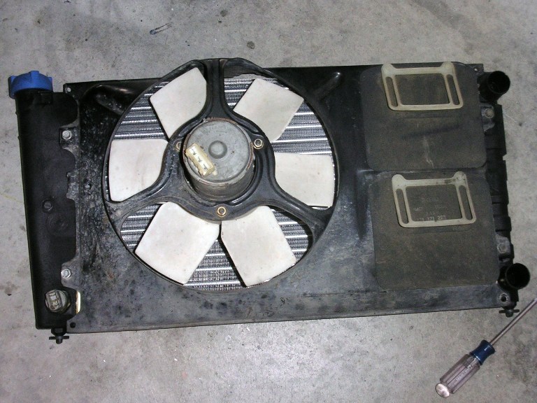

I would suggest using a fan shroud with flappers that will bend with higher speed, opening "widnows" and therefore increasing airflow through radiators. Audi uses this approach on many of its models.
Like this (ignore the circles):
