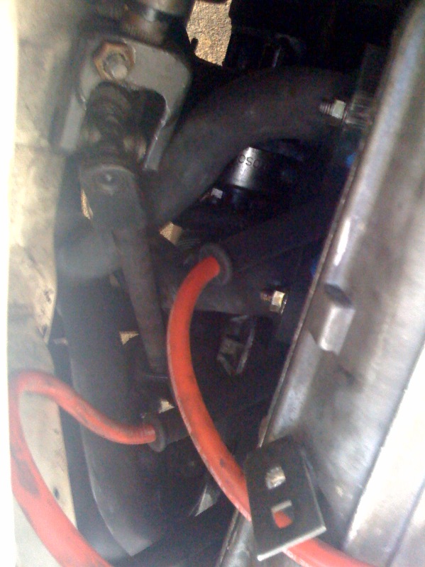

PostPosted: Mon Feb 08, 2010 12:03 pm    Post subject: Reply with quote
I got one off ebay a while back for AUD$80...!! Works a treat. Not the best photos but as you know there's not a lot of room down there!

PostPosted: Mon Feb 08, 2010 12:09 pm    Post subject: Reply with quote
MMM I must say your a lucky devil (no offence) those pics will help a lot though , can you e mail them to me if possible?

PostPosted: Mon Feb 08, 2010 12:20 pm    Post subject: Reply with quote
Yup I couldn't believe it when they came up with a "Buy It Now" price crazy low...
Email on it's way, but they are the same pics here - I don't have hi-res versions of em unfortunately.

PostPosted: Mon Feb 08, 2010 7:19 pm    Post subject: Reply with quote
These pics are fantastic guys, it seems that the only problem would be trying to find a way to get the steering column between no 2 and no 3 exhaust pipe. emoore924 if its not much trouble could you post some pics of the d prod exhaust, Iv been sent a pic of a Bursch exhaust (not very clear though)it seems as if the 2 & 3 pipes are a bit well spaced too. i will take a closer look though at all the pics and show them to a guy who told me he might be able to work something out.
