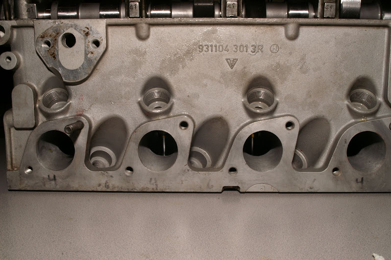

Do I understand correctly that there is a coolant passage in the flange of the intake manifold and therefore taking it off requires draining the coolant?
Or is that not what ther recess in the flange is for?

I've often wondered about that recess on the intake. I don't have any pictures handy of an NA head here at work, but on the 931 head, there are no water ports that could possibly feed water into that recess.

Hmmm. the picture in the Haynes does not show any ports on the flange either. But how accurate is the drawing.

100% there is no water in the inlet manifold on either the N/a or Turbo.

well the recess does suggests it is a channel that connects different ports on the head, so there is no water 'in' the manifold, but it could flow along the manifold. But if you are so sure, I will believe you

But if you look in the PET there is a recess in the head too.

No accommodation for recess here.

But thats a turbo head:
Here's the pic from PET

I know. That's what I indicated. But remember, on the NA head, there is a one piece intake manifold gasket that completely covers that recess anyway, and there are no water jacket ports there. As I said, I've often wondered about the recess but have never been able to figure out it's purpose or function.

Took mine off one night to get to the WUR, no water.

No water.
I've seen the channel and ports too and the only thing I can figure is some sort of pressure balancing between the exhaust valves/chambers or something. If you poke a wire or something into the holes it reaches all the way to the base of the exhaust valve. Primitive emissions controls of some sort probably...
I'll ask my engine guy next time I talk to him and see what he says.
