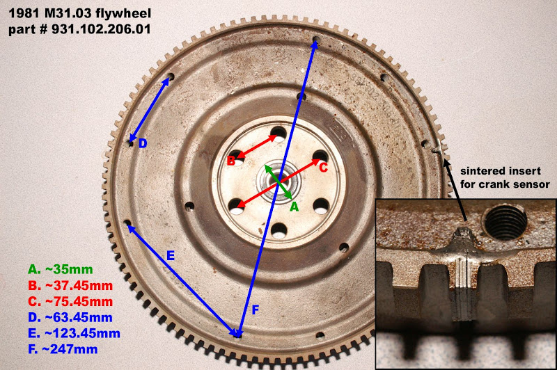

Well, for starters, the S2 "trigger wheel" is not a 60-2 setup...so triggering off of the sintered insert on the flywheel will require a system that can be set up for a completely custom arrangement.

The DITC-equipped cars have a sintered insert on ring gear. There is no missing tooth. So the crank trigger picks up on the sintered insert when it comes flying around, as opposed to detecting a missing tooth. Sort of the inverse of how missing tooth setups work. I don't recall offhand how many teeth are on the flywheel though. I'm sure there's a way to get it to work, but honestly, I think you'd be better off to just bite the bullet and figure out how to mount a proper 60-2 or 36-1 wheel up front. Having to dork around with the flywheel inside the bellhousing and the reference sensor mounted to that little tiny window is a royal PITA once the engine is in the car. I'd rather have my sensor and wheel up front for easy access.

ya, that sounds pretty bleh alright, not sure if anything out there right now could properly trigger off that.

Here's a pic of the S2 flywheel:
aah right... I obviously had that completely wrong then. I must have misunderstood some of the posts I had read through. Thanks for putting me straight on that.
Looks like a front-mounted triggerwheel it is then.
