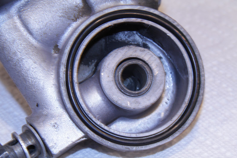

Here are some pix to illustrate why this o-ring should be replaced.
New one on left, old one on right...a little hard to tell in this pic, but if you look closely, you can see how the old one is flattened out and square. In other words, it's lost it's rebound ability. What the pic also doesn't portray is how stiff and almost brittle the old one is. I can assure you that the new ones, when they were available, had the round profile like the new on on the left.
Here's another pic that shows how the old one is flattened out.
New one in the oil filter console:
Old one in the oil filter console:
