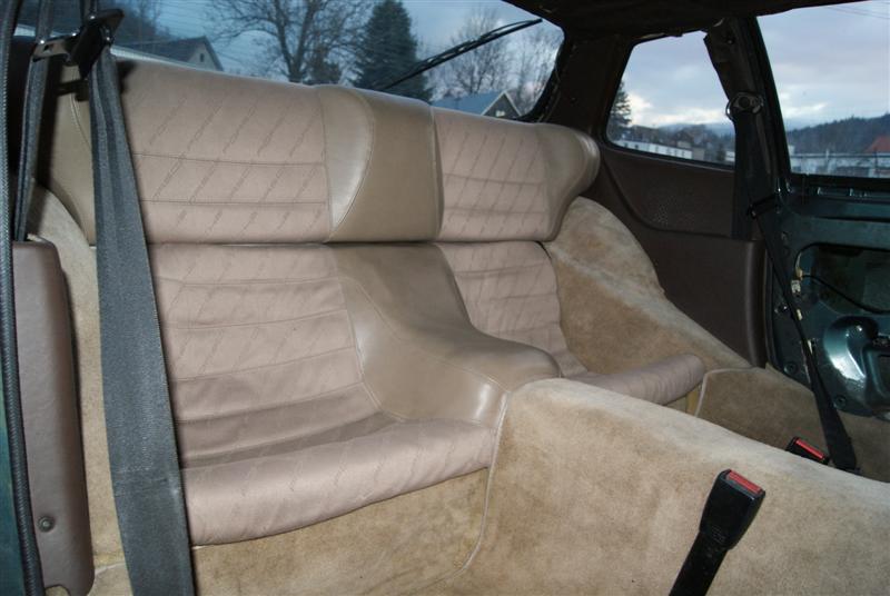

I have newer seats in my 931 coming from 924'84 or 924S I think... I had previously old type... and that captive bolts can be swapped directly, without problems. There are just two screws holding old captive bolts in place on each side, and boot work ok with new type captive bolts... Only problem was to find proper size screw which will fit captive bolt plate and hole in body.
From my car:
Old style rear sit mounting (previously) :
New style (now):

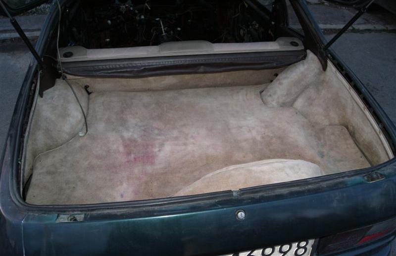

My car has now interior from 924 from 84 or maybe 924S... don't know exactly... but it has trunk carpet with full size tire place... I had space saver so it not look such great as it could. And whole interior parts (seats, carpets, dash) was swapped from one car, so no one changed trunk carper for some older one.
