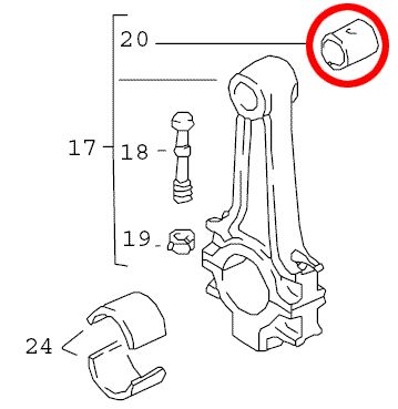

Hi Guys - Anybody know of anywhere/anyone who might stock Little End Bushes p/n 059 105 431 for the 924/931 con rod?
I have obviously tried all the usual suspects such as EBS, Paragon, Auto.Az, etc. Is there somebody else I should be trying?
